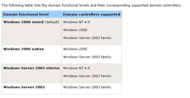

    We have Windows 2003 on that server and its in "interim" mode? From what I've been reading native and mixed mode apply to 2000 and not to 2003. Please correct me if I'm wrong.

    RyderOCZ wrote:
    Native mode means you need minimum of Win 2000 to access a server. (I think, not 100% on that at the moment)
    I'm not sure either but I think the mode just dictates the functional level the DC's will operate at....not necessarily what type of work station can attach. The newer your DC's, the higher level of functionality. I'm not positive either.
    Here are the modes, straight from the help files of Server 2003.
    Lots more on this issue here on the MS TechNet site.

    I thought I had that backwards Mtrox.....it has to do with what servers/DC's are allowed in the domain....Thanks for that :)
    Sorry to lead you on the wrong path Soulo4, nothing worse than looking for help and getting bad information :eek::doh:
