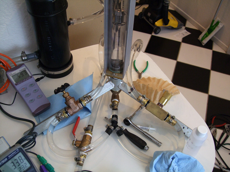

Well, I've finally gotten the most recent iteration of my CPU waterblock test system together... fun stuff. Photos, a few details, and a somewhat incoherent video tour are below.

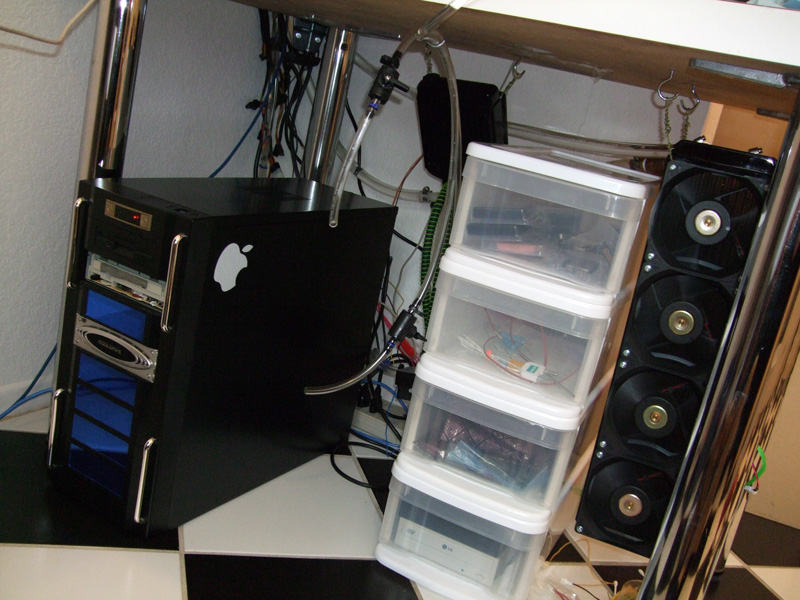

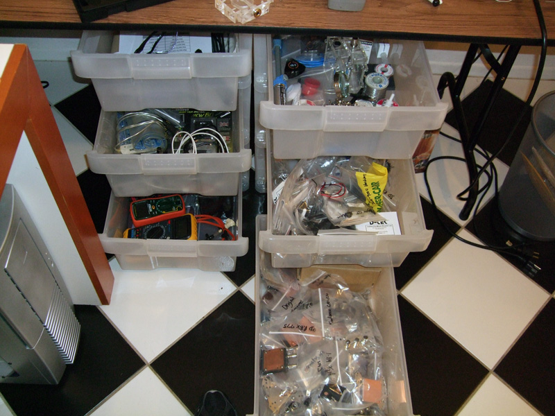

I plan on using the system to run through and test most of the blocks in that drawer, with my goal being to put together a reasonably comprehensive library of CPU block performance data (ranging from old blocks like the WhiteWater to the latest stuff on the market) all gleaned from the same test system and, therefore, directly comparable (also somewhat more relevant, due to the presence of a soldered IHS). I'm not going to go too far into the details right now since I'm pretty tired and will likely botch any sort of explanation of what I've been up to for the past five years... lol

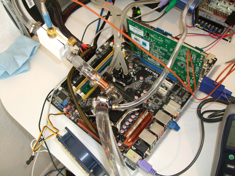

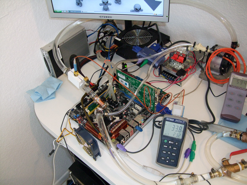

With that said, here's what's on that table covered in stuff:
- Omega FL-1504A-B flowmeter
- Sper Scientific 840081 manometer
- Extech EA15 data logging thermometer
- Volt-modded Asus P5K Deluxe
- Instrumented Intel E6400 (details on the process can be found in an early test run that I did with some heatsinks back in 2008 here...I've learned even more since then and have some new tricks up my sleeve)
- Iwaki RD-30 pump
- HW Labs BlackIce GTX480 radiator
- (8) Delta EFB1212HHF fans
...and some other junk you probably don't care about.
