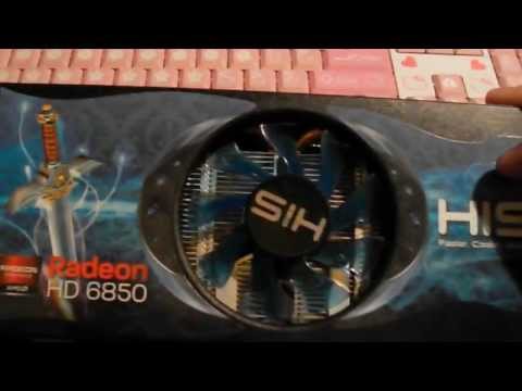

However, I did not know at the time that the card had a history of cooling fan failure and sure enough, mine just started squalling. I opened the card to see what I could do to quiet it down (dumb, I know that probably voided my warranty, but since HIS has a hit-and-miss reputation on warranty service, I tried anyway) I removed the fan and peeled the sticker off its center hub to look for lubrication points. There weren't any. Since I found nothing I could service, I reassembled it and put it on the shelf. I Googled fan replacement for the HIS HD 6850 and found a youtube video about this problem from a general user. It was his belief that if you had a blue HIS fan, you were dog meat if it failed. If you had the red fan, you were golden. Okay, so I am officially dog meat.

    Red fan/Blue fan..............here's the video I referred to in my original post and it is amusing too (to me anyway):
