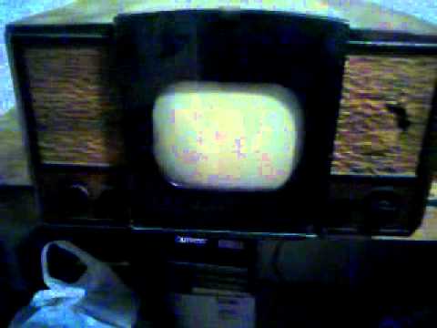

So, this thread caused me to fall down an internet rabbit hole and I've spent the last hour looking at the history of TV. Here's a cool video I found of a guy that hooked up a Sega Genesis to one of the first TVs, the 1946 RCA 630TS.
