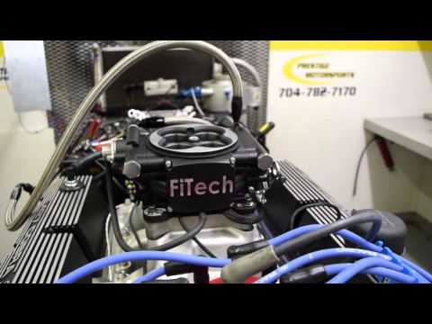

I decided to ditch the carbs and go with an EFI system that will utilize the same intake manifold. Summit is taking the carbs back as an exchange for the new system as i have not broken the seals on the boxes and am spening more for the EFI. Here is a video on a single throttle body 4 barrel by Fi Tech. This is a self learning system that can be tweeked and maximizes performance with a lot less hassle. I am going with a 2x4 barrel setup capable of 1200+ HP.
