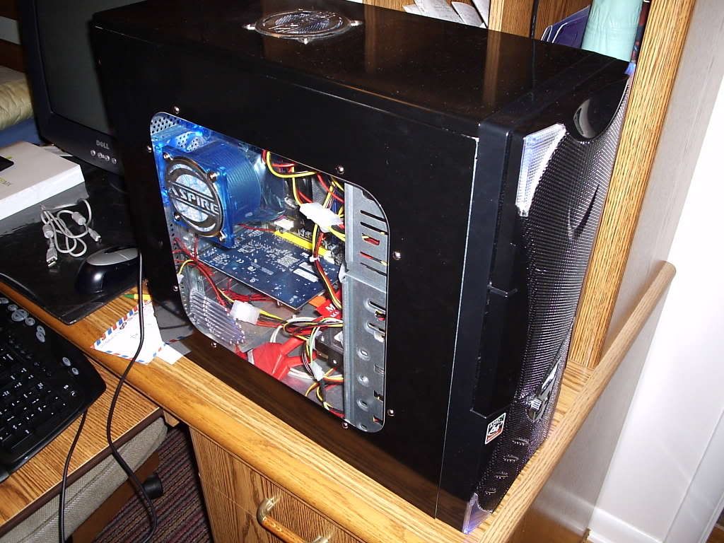

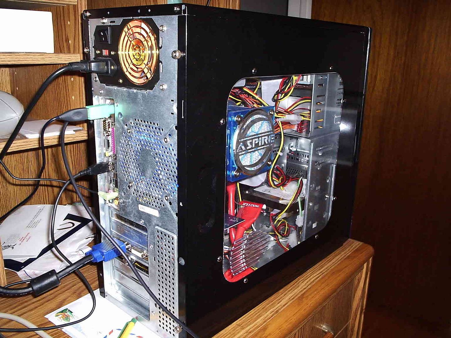

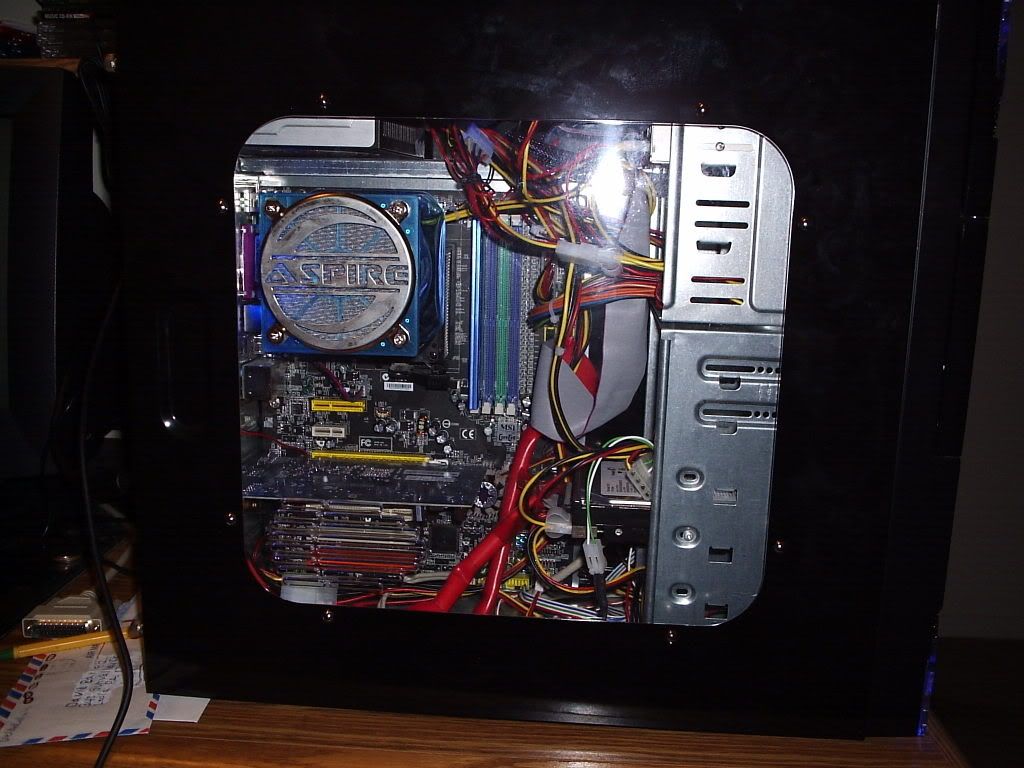

Concerning your specific computer case configuration, you are not likely to experience improved cooling unless you install a front intake fan. Airflow patterns in a case are just as important as air flow volume. You did not give us the make and model of your case. If you would do that and also give a link to a picture, we'd be better able to understand it's cooling potential.
There's a diagram I made to show where my optical drives, hard drives, and power supply are.
Side view of my actual computer. These pictures are kind of old, but it's basically the same now.
Back-ish view.
Front-ish View

If you don't want to cut your case, that's fine, we understand. But there are limits to your case's cooling ability due to it's design limitations.
"All exhaust is OK" Hmm, not sure I know what he meant either! Looks like you are at about the cooling limit of your case the way it is currently configured. If it does everything you want it to and is stable, just leave it be. If you want to improve cooling, I don't see any way around doing some case mods. You could try a more powerful CPU heatsink, but that might not help much if the air that is sucked into the heatsink is not fresh and cool enough.
Living with what you have is ok. If its stable then there is not really anything to worry about.
You could also try a 100mm hole driller to cut the metal in a perfect circle and file the edges, no one would probably tell, esp since its the back of the case. Most people will be looking at all the perty lights. I do believe a new fan grill to be the cheapest/best way to lower your temps.
